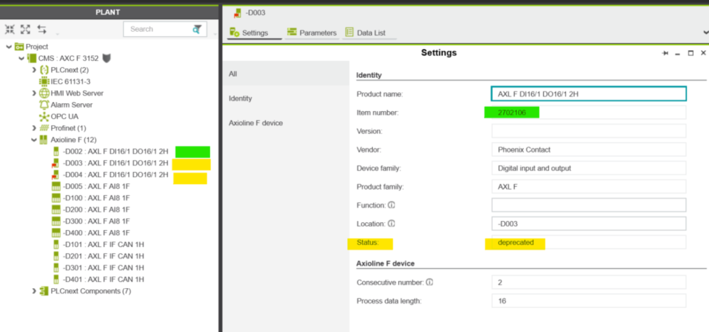

Playing around in the 2025.0 LTS version of PLCnext engineer, I keep getting this warning.
Why the warning, and why on only 2 out of 3 identical cards? They have the same part number, and 2 of them are reportedly deprecated while the first is fine.
Any tips?

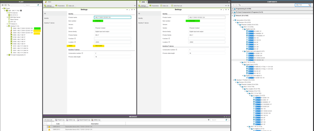

I see that the resolution of the image was downscaled, so here is a zoomed in version so that text is readable:

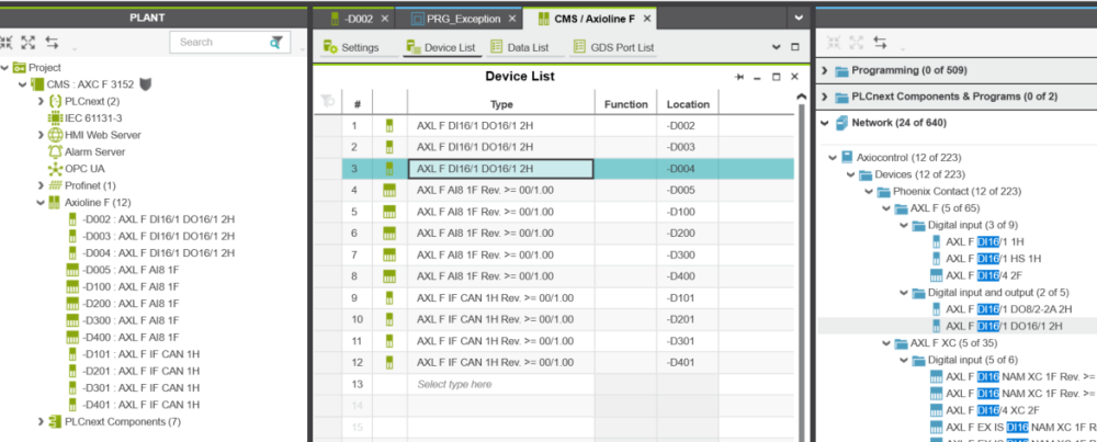

OK, I resolved the issue by simply copying the same device from the components view and right-click->replace on one of the two cards with deprecation error.
I’m guessing that this has something to do with this section of the Change Notes for PLCnext Engineer 2025.0 :
image.pngMaybe older PLCnext Engineer projects used an earlier (now deprecated) version of the device description file for that I/O module, and replacing the “deprecated” module with itself in version 2025.0 updates the device description file …
