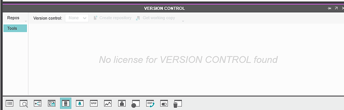

I am looking into Version Management using a VCS at the https://engineer.plcnext.help/2024.0_LTS_en/_index.htm#
Before following these steps, I have the following message in the toolbar:
I am able to acces git from external apps (added to environment variables). I am unable to find anything in the docs about a license.
How can I make use of this?
Dear Mr. Smets,
the VCS function in PnE needs a license which could be generated via our E-Shop.
You can configure the license in the following way.
Have a nice day !

You do not “need” the built-in version control system to use GIT with a flat project. I dont.
There are a few advantages by using the built-in, but mostly because it describes what most of the files actually are, while in normal git you might not know.
Also there are a ton of features missing from the built-in VCS, but for some light users it might do the trick. I dont understand why Phoenix actually want to charge money for this functionality.
Dear all,
for those who wanne test the internal VCS/GIT client functionality, a trial license is installed with PLCnext Engineer.
To activate it, you only need to use the file explorer and search for the PLCnext Engineer installation path in the folder
“C:\Program Files\PHOENIX CONTACT\PLCnext Engineer 202x.x\Licenses”
Inside that folder you can find so called Trial licenses which offer the AddIn for a test perioud of 14 days.
Please be aware that trial licenses and even emergency licenses(7 days) are only activateable once on each computer.
