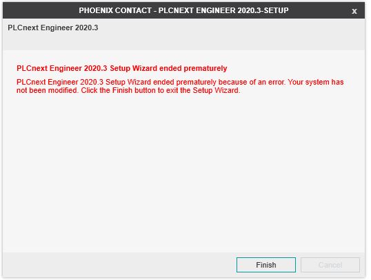

Hello Sir ,unfortunately,even worse, I couldn’t install 2020.3 PLCnext engineer at all. And the prompt message is very limited . So could you help me to anysls it?2020.3_failed.JPG
Hi, I’ve spoken with the dev department. It seems that this issue is quite often related to some user rights and or some virus scanners, they suggested me the following:
                                               * Deinstall PLCnext Eng
                                               * Delete the user config files (/users/youruser/AppData/Roaming/Phoenix Contact/PLCnext Engineer/Version/user.config
                                               * Deactivate your virus scanner
                                               * Reinstall PLCnext Eng with Admin privileges
                                               * Start PLCnext Eng with Admin priviliges
Keep also in mind that you need Windows 10 64Bit! If this still not help please contact your local Phoenix Contact sales representative to get in direct contact with you. Reg Frank
