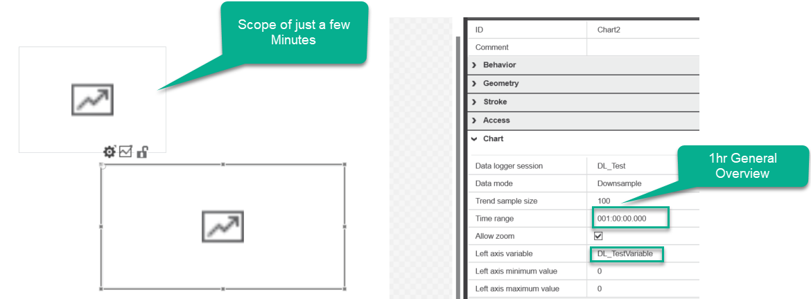

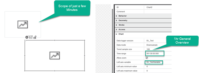

Hey Andrew, without knowing too much details from your requirements I would guide you to the charting object in combination with the build inreal-time datalogger real-time datalogger. Just for example you could show the current values from the last hour (live values) in a chart object with a time frame of 1hr. The charting object is connected to a tsdb datalogger which only records the values for this time frame. In another charting object you could display than the averages during from a much larger time frame, just as an overview. The averages were than be calculated from your application (as I guess you already did) and than stored in another tsdb datalogger. Hmm, just a suggestion. Take care, Frank
