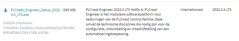

Hey Joseph,
I would recommend you to try out PLCnext Engineer Version 2022.0 (LTS).
The Long Term Support Version is much more stable than the newer versions. So if you do not need anything of the newer features in PLCnext engineer, I would strongly recommend using the LTS version.
Cheers
Hidde35
