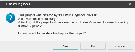

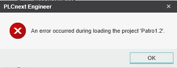

Hi, i don’t use EN/ENO feature. The project cannot be opened. Conversion doesn’t offer it. [attachment]pne2021_3.png[/attachment]

OK, I haven’t seen that before. We may need to get a PLCnext Engineer project from you that shows this behaviour. If it’s is OK with you, we will send you an email (to the address you used to register on this forum) with instructions on where to send the project file. Please let us know if that’s OK.

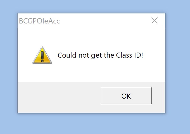

Hi, I tried it on another computer and the project converted well. [attachment]Snímek obrazovky pořízený 2021-04-15 13-17-32.png[/attachment]
