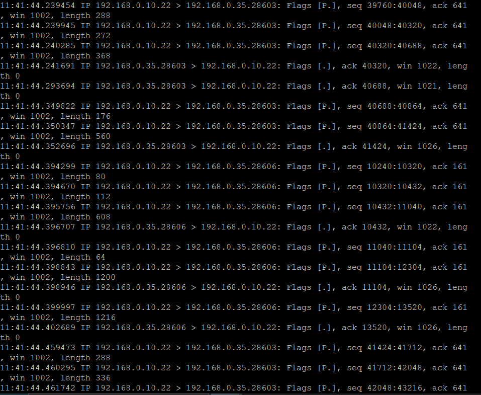

After manually setting my eth0 interface into promiscuous mode, I still don’t get packets which are not meant for my PLC.
image.pngAfter this, when I try to see my packets by using tcpdump command, I only get packets which are meant to be sent to/from PLC:
Is it actually possible to set my eth0 interface to promiscuous mode?

Hello fkatulic,
this is probably not helping because the AXC F 2152 has an internal switch chip that already filters traffic thats not meant for the device.
Eth0 → internal Switch KSZ → External Network.
