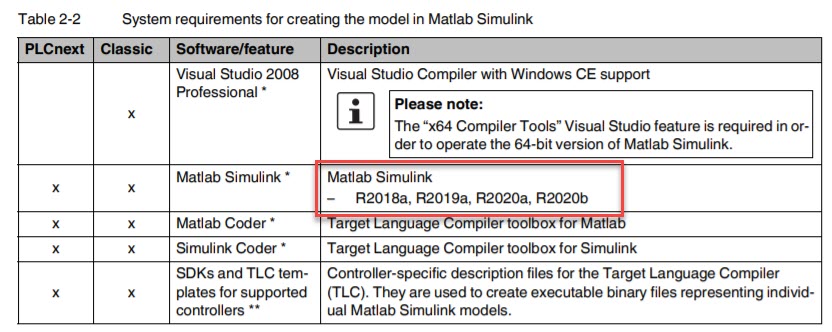

hi,I have a question about simulink ; install Matlab 2017a and PC WORX Target for Simulink (v1.4 / v1.5 / v1.6),and install PLCnCLI_SDK_2021.0_LTS_Windows_AXC_F_1152 ; The result is MENU—not found the PlcNext Tool or click SDK manage ,message not “source”. how to solve this question. thanks hi,您好,我打算使用matlab simulink仿真,按照操作sop安装软件时,发现和提供的不一致,没有出现该选择项,且安装中文版后也是如此, PC WORX Target for Simulink(V1.6)安装时老弹出不满足要求,需要安装matlab 2017a,我已安装,是不是设置有问题? PC WORX Target for Simulink(V1.5)安装后能显示PLCnext工具,但有新的问题,点击SDK manage后弹出不存在资源,所以该怎么解决。
The latest version of the Simulink add-in has these requirements: [attachment]2021-05-17_10-25-34.jpg[/attachment] It looks like you are using Matlab R2017b.
thanks,matlab R2019a test is ok
