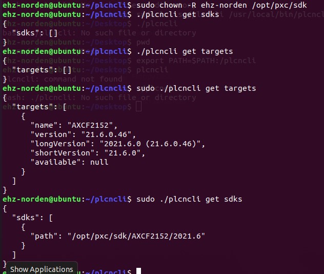

When I am trying to check the SDK targets after the installation, then I got an empty path.
Hello Samanthap, did you install just the plcncli or also execute “plcncli install sdk --path … --directory …”? To install a SDK? kind regards, Oliver
Hello, also did this command: sudo ./plcncli install sdk -p pxc-glibc-x86_64-axcf2152-image-sdk-cortexa9t2hf-neon-axcf2152-toolchain-2021.6.sh -d /opt/pxc/sdk/AXCF2152/2021.6 after that I tryied to check the skds path.
Hey, as you installed the SDK using sudo you probably do not have permissions to the SDK using the plcncli without sudo.. Either change the permissions of the folder /opt/pxc/sdk or execute the command using sudo sudo chown -R ehz-norden /opt/pxc/sdk
With “sudo” I can see the path of the SDK and the target.
Hello, so to make it usable without sudo. 1. change permission on /opt/pxc 2. move config files /plcncli → /home//.config/plcncli 3. change permissions on the /home//.config/plcncli then you should be able to use plcncli without sudo. kind regards, Oliver
Note that the problems described above can be avoided if the PLCnext CLI and the SDK(s) are initially installed without using sudo.
