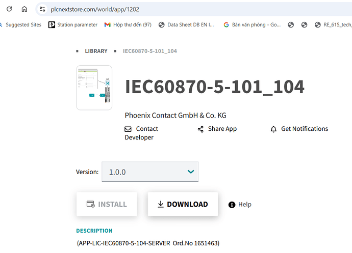

2. I need using IEC60870-5-101_104 from store( see picture). Is SD Card mandatory to come with it?

For the question about the SD card - if the app documentation is not clear on this question, then you can contact the developers of the app using the “Contact Developer” button that can be seen in your screen shot.
