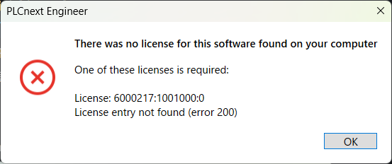

After the installation of PLCCNExt VErsion 2024.6 i get the following error message - CodeMeter License Server missing Error 200
I have tried reinstalling PLCnext Engineer.
Is there anything else I can do?

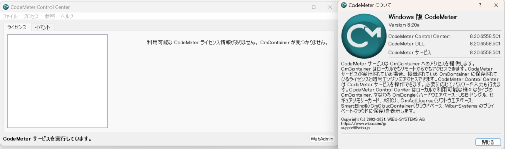

Could you please try updating to CodeMeter Runtime version 8.20?
You can download the software from the Wibu-Systems homepage :
Software für Anwender - Wibu-SystemsAfter updating, please restart your system and try launching PLCnext Engineer again.

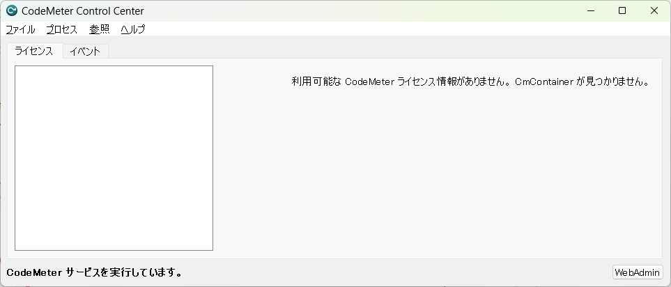

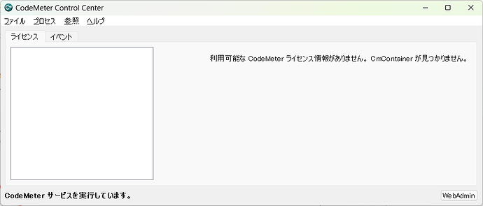

It seems that the system is currently unable to detect a valid license. Could you try applying the 2nd Basic License and check if it resolves the issue?
Steps to apply the 2nd Basic License:
1. Extract the attached ZIP file
PLCnextEngineer_BasicLicense_2nd.zip - You will find a file named PLCnextEngineer\_BasicLicense\_2nd.WibuCmRaU inside.
2. Open CodeMeter Control Center
- Search for " CodeMeter Control Center" in the Start Menu and launch it.
image.png3. Import the license
- In the CodeMeter Control Center main window, open the " File" menu.
- Select " Import License" (or " License Update").
image.png - When the dialog opens, select the extracted PLCnextEngineer\_BasicLicense\_2nd.WibuCmRaU file.
- Click " Import" to proceed with the import.
4. Verify license application
- Once the import is complete, check if PLCnextEngineer\_BasicLicense\_2nd appears in the license list within CodeMeter Control Center.
