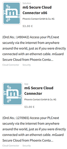

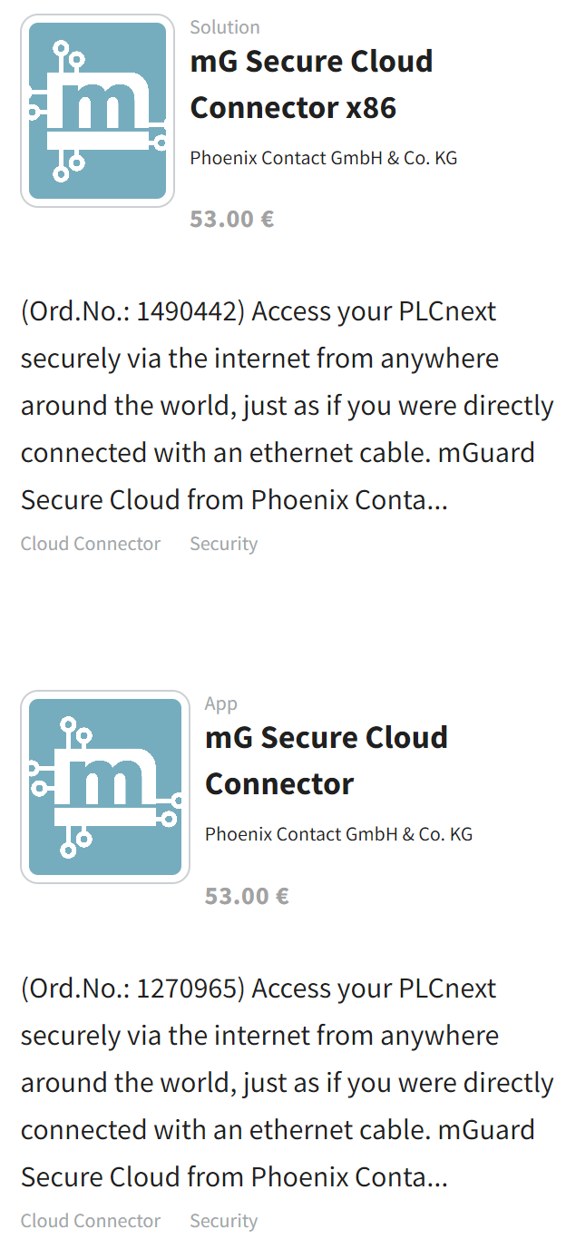

I understand that I will probably need the mGuard Secure VPN Client for my Laptop and the mG Secure Cloud Connector for every plcnext controller. But what is the difference between the following 2 apps? Which one do I need for my AXC F 2152 controller?
Do you have any other suggestions or tips for this?
what is the difference between the following 2 apps? Which one do I need for my AXC F 2152 controller?Please read the information for those two apps in the PLCnext Store. In particular, the “SUPPORTED DEVICES” section will answer this question. If you need more technical information about these apps, please use the “Contact Developer” button on the app page.
My understanding is that mGuard Secure Cloud can probably satisfy your requirements in this case. For information about mGuard Secure Cloud, including the features and the hardware and software requirements, please contact your local Phoenix Contact sales office.
