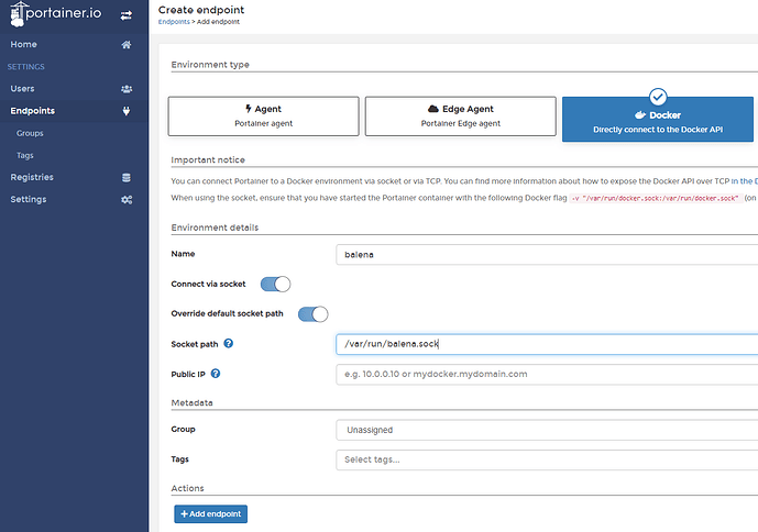

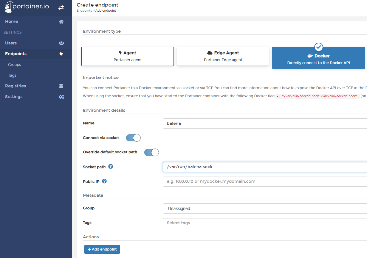

Thanks for the feedback. However, with 1.0.4 the endpoint (balena runtime from the store) is not reachable: Failed loading endpoint Unable to proxy the request via the Docker socket. This also occurs with 1.0.1, but when I STOP and START the Portainer 1.0.1 App in in WBM it works, with 1.0.4 it does not…
Hi, for balena or podman you have to configure the socket endpoint. Please try “/var/run/balena.sock” or “/var/run/balena-engine.sock”
