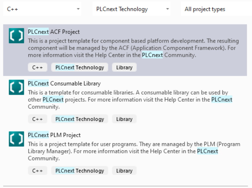

What type of program should I choose in MS Visual Studio when creating a C++ program? I cannot understand the difference between them.

There is some information about the difference between ACF projects and PLM projects in the PLCnext Info Center, on this page:
Managing of components The Application Component Framework (ACF) is a part of the System Manager and manages the function extensions. The ACF is a framework that enables component-based platform development and configurative composition of the firmware for different devices. It enables dynamic and configurative integration of user functions into the system. There is more detail in the sections of the Info Center related to C++ Programming.
To your specific application, there are probably a few alternative solutions, depending on the requirements of the application (e.g. data frequency, accuracy of timestamps, etc). Some possible solutions do not require C++ programming. Some potential solutions do not require the PLCnext Runtime to be extended at all, but if it does then I suspect you’d be looking at an ACF component (again, depending on the requirements).
