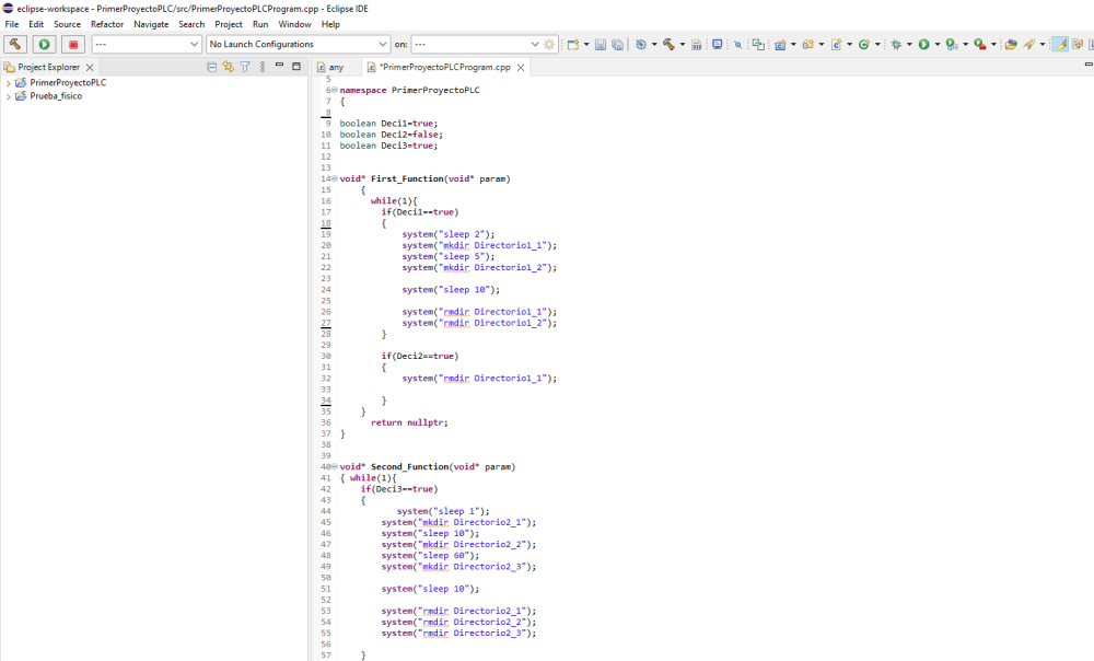

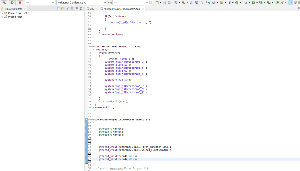

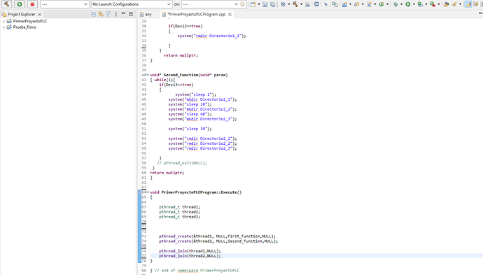

I am trying to implement a program in C++ to later upload it to PLCnext, the program in question must create two threads, to test it I made the code that creates and destroys some directories.
When loading it for the first time in the AXC F2152 it gave me an error and the driver was blocked.

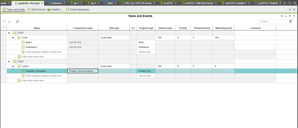

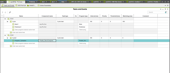

Reading I found that this error could be due to the watchdog, so I created a new cyclic task, set the watchdog to zero and in this task I execute the program in C++, now it works without problems.
Could someone tell me if I’m correct that the failure was due to the watchdog?
Is executing the program setting the watchdog to 0 correct?
Could it give me problems that I am not seeing now?
Thank you very much.
_Could someone tell me if I 'm correct that the failure was due to the watchdog?_Yes.
Is executing the program setting the watchdog to 0 correct? It’s not advisable to disable the task watchdog by setting the value to 0, except while debugging/troubleshooting, or to set the value to greater than the task cycle time.
The purpose of an IEC 61131 cyclic task is to execute all the program instances in that task, one after the other, once every cycle period. The sum of the execution times of all the program instances in a task should never be more than the task period, and the Task Watchdog is a way of guarding against bugs in the application that might cause programs to execute for longer than the task period. For example, if there are any loops in a program that take a “long” time to execute, then the execution time of the program instance might exceed the task period, which is something that should be avoided in IEC 61131 cyclic tasks.
In your case, if I am reading the code correctly, the C++ program instance will block the task execution forever, because the Execute method joins two threads that will never terminate.
In this case, if a deterministic cyclic task is not a requirement of the application, then it might be better to implement the solution in a Component rather than in a Program.
Could it give me problems that I am not seeing now? Yes. If an IEC task is blocked forever with the watchdog disabled, this is likely to cause problems.

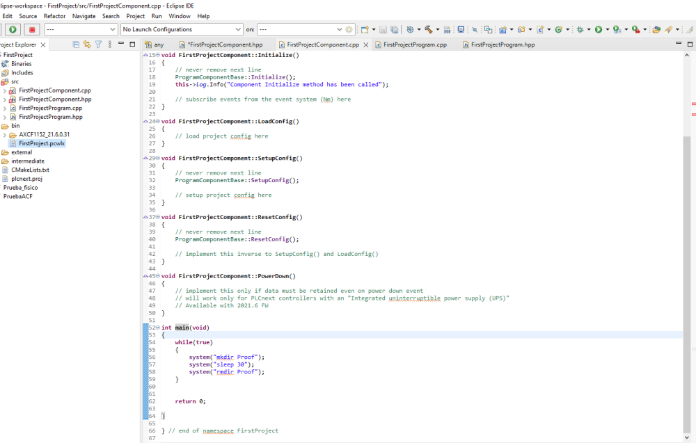

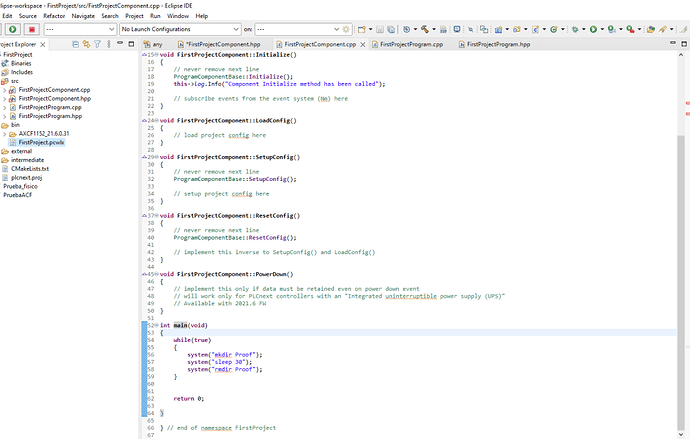

Now I was trying to use the default component when creating a project in Eclipse and similar to what I had at the beginning, I created and destroyed a folder (I’m checking it in the simulation). However, I find that it is not working.
From what I saw, should /opt/plcnext/projects/Default/Plc/Plm already have auto-generated files? I ask because Plm is empty, even assigning the program to PLCnext enginner.
Am I missing something else to add to the project or what am I doing wrong?
