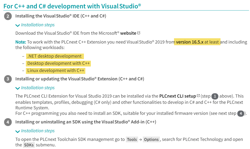

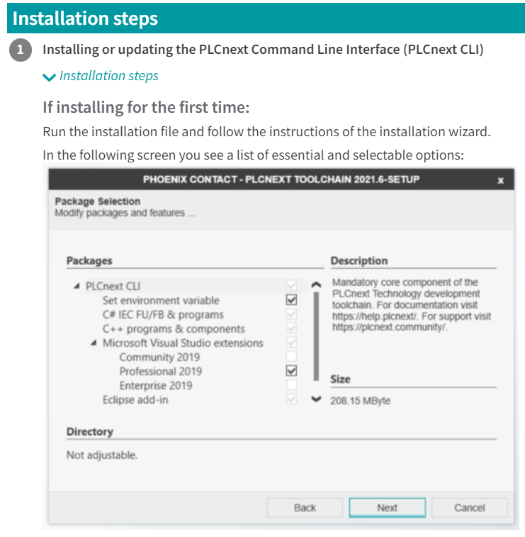

Please check that you have all the required installations:
Required Installations from 2021.6
PLCnext CLI and PLCnext Technology SDKs for different PLCnext Control devices are available at phoenixcontact.com/products in the download area of the product page for each PLCnext Control. See Tool downloads for an overview and direct links to the respective product pages on phoenixcontact.com .
