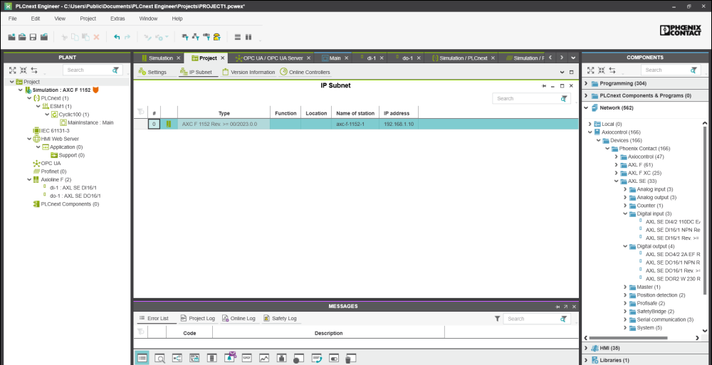

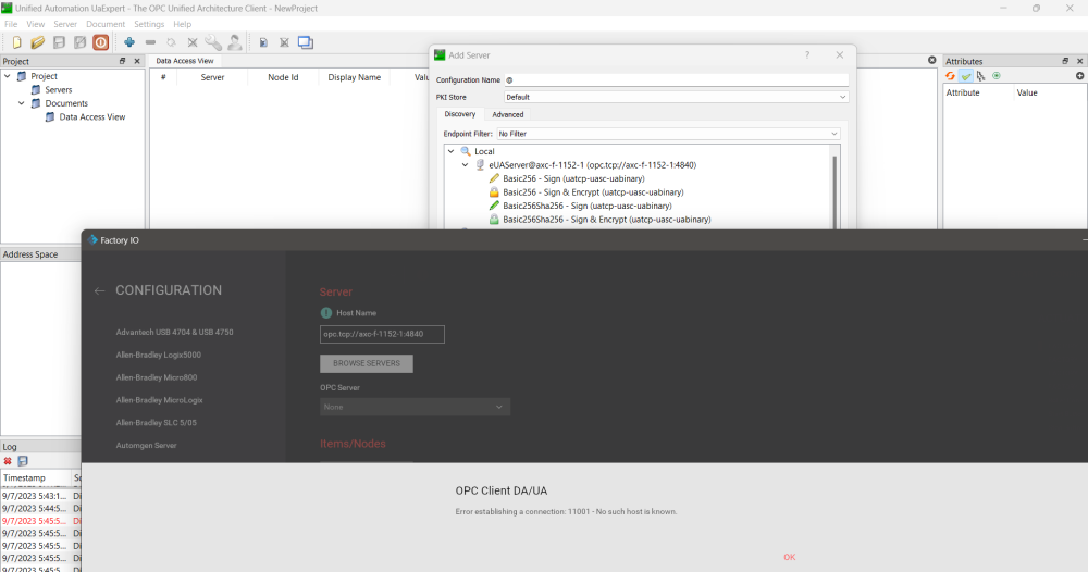

i need to connect plcnext axc f 1152 in simulation mode with Factory what should i do ?
my config

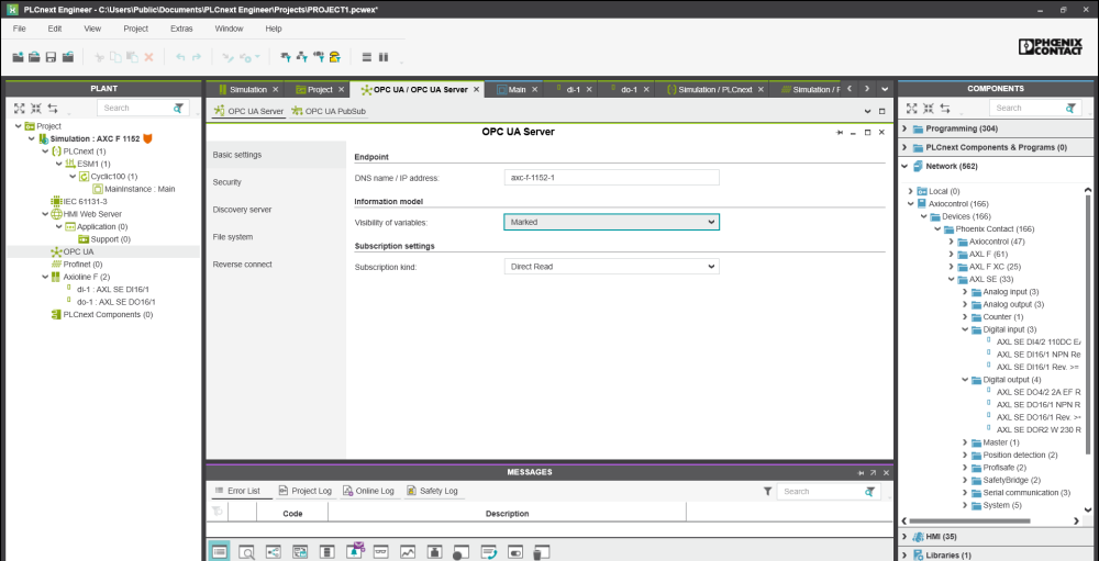

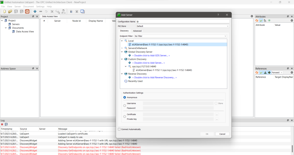

i see it but it is not simulation mode i search and i found UaExpert is must install but what is server name ?
The server is the name or IP address of the PC running the simulation, or localhost or 127.0.0.1 if the OPC UA Client is running on the same PC as the simulation.
PLCnext Engineer Simulation The PLCnext Engineer Simulation makes it more convenient to test and optimize your PLCnext Engineer applications, because developers no longer depend on a hardware target attached to their computer.

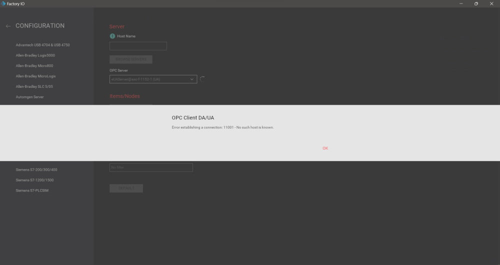

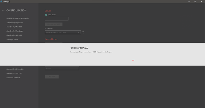

i see it local but when i connected give me this massage
If you can connect to the OPC UA Server using UA Expert, but not Factory IO, then it looks like a problem with the Factory IO configuration, not with the OPC UA Server.

I think the problem is here
