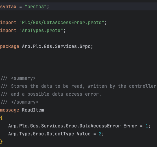

The proto file fond on Github are outdated (2 years) and I’m having problems to generate the stubs for golang. The windows batch file does not helping. I’m building and generating protobuf stubs on linux.
I had to decrease the protobuf linter validation (using BUF) in order to generate stubs. I just want to make sure that it will be usable. At this point I’m sceptical.
I notice, there is no versioning in the stubs and it’s not really follow the protobuf standard…
For instance: directory does not match with package, etc…

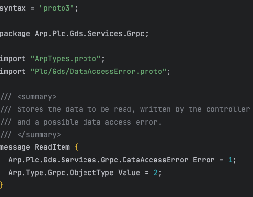

ReadItem.proto: Package need to be above the import
Should be: But there is still import and package that are not consistent.
