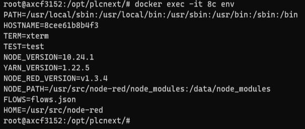

I have following try out: docker run -d -e “TEST=test” nodered/node-red [attachment]Untitled.png[/attachment] Can you alternatively set the env over a flow? Using environment variables : Node-RED
