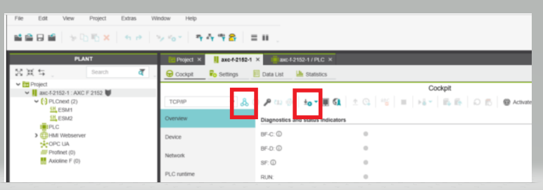

Hello Mehran, the settings are correct. Do you tried to use the connect and send project to PLC buttons in PLCnext Engineer (see attached screenshot)? Best Regards Eduard

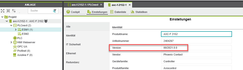

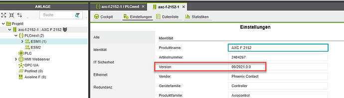

Hello Mehran, is the PLC Template matching to the installed Firmware Version? [attachment]TemplateVersion.jpg[/attachment] You can not!! connect with an NEW template to OLDer FW versions. Connecting older versions of a Template to New FW Version is okay mostly but new features will be unavailable. kind regards, Oliver
