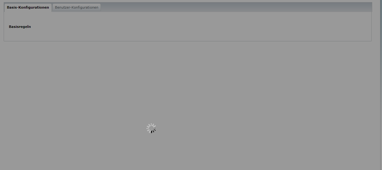

So i try it like in the link descriped and it works. it was also possible to install a packages. But after a reboot the container is not able to connect to the internet. Also the firewall status in the wbm is a little odd - i only get a circe running, and no text in the background. So i got no idea what the problem is… Do you have any idea? I also run “update-rc.d -f firewall remove” but this make no difference For the Records: I reset the controller to factory settings and try it again. At this time everything was working like expected and there was no problems. Node-Red is working and i can install flows at any time.
that loading screen is normal for the 2020.6 workaround.
Deactivated the Firewall manually means that the service is not running that supplies the data…
This workaround will no longer be necessary with 2021.0
Also if you need to go productive with 2020.6 and need a firewall you can revert back to IP Tables=disabled and then set up the NFT rules like it was done for FW < 2020.6.
