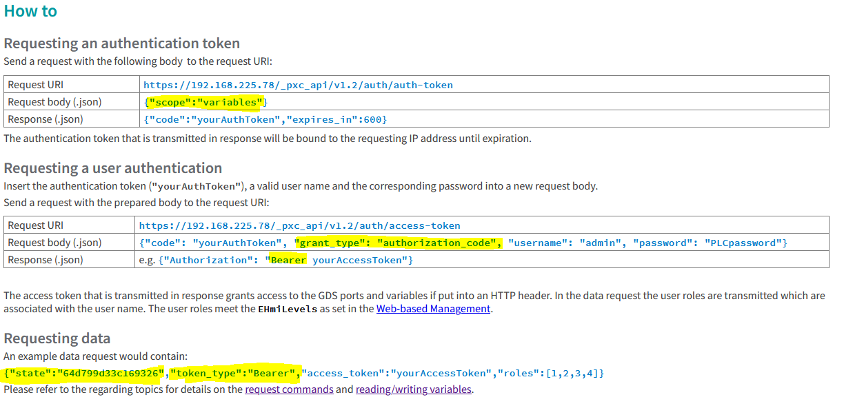

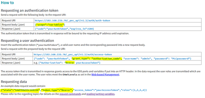

Hello Frank,
you've linked exactly the section I was talking about.
If you take a look at the "How to" part of the text you will see that there are parameters/variables used but never explained.
The example also looks like you are using the access token in the JSON data, but in the explanation of the procedure (E and F) it looks like you have to send the access token (bearer token??) in the HTTP header and not in the data....

Hi Mathias,
now I got your point and yeah I can also there also some improvements in the doc of the REST Interface.
Until this is done I hope the following prints from my Py script will guide you through authentication and data service calls.
