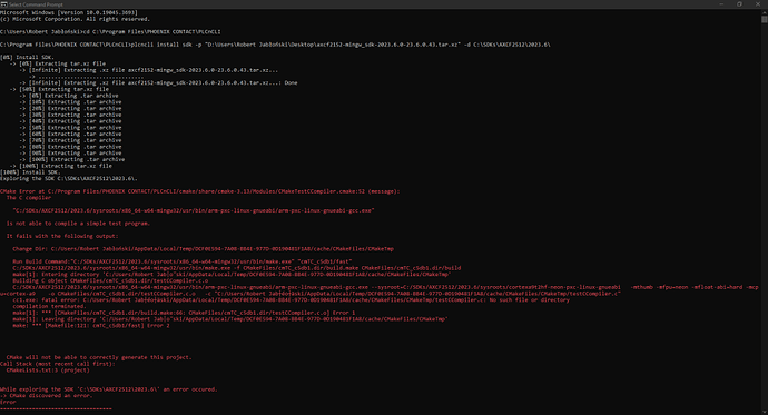

I’ve got a problem with the installation SDK file. During installation, I got this message:
I’m using PLCnCLI in version 2023.0 LTS and SDK version 2023.6 for Windows. System is Windows 10.

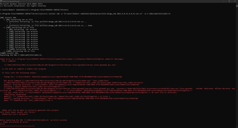

Thank you for this link. I installed the newest version, but unfortunately, I still got the same result:
It turns out that this is an issue with CMake.
During the installation, files are creates in the user’s AppData directory, e.g. C:\Users\Martin\AppData\…
You can see this path (with your user name) in your screenshot.
If the user name has special characters - like ł or ń - then the path will contain characters that CMake cannot handle, resulting in the error that you see.
The solution is to create a new Windows user that does not have special characters in the user name.
Sorry for the trouble, but this is a CMake issue that is outside our control.
