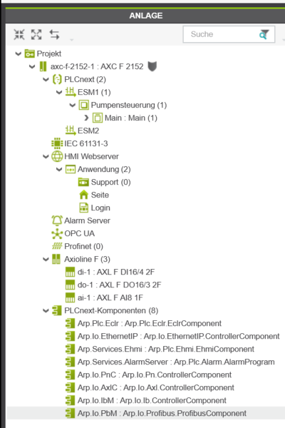

After that (and a controller firmware update) we see a few “Arp…” - topics below “PLCnext components”. Unfortunately I can insert only one image. :confused:

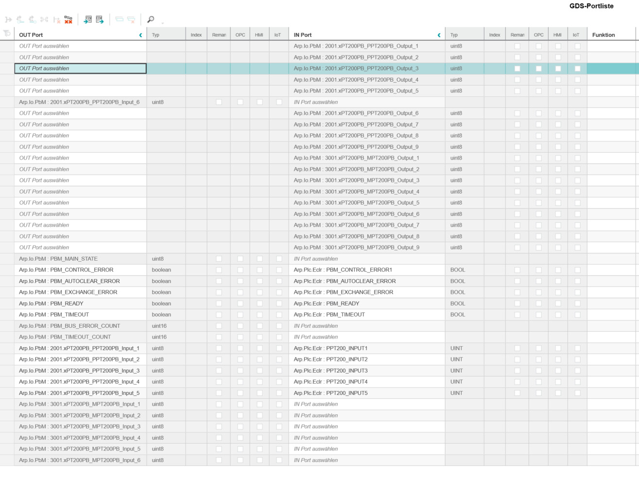

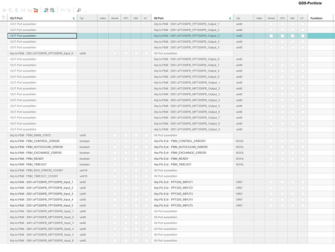

I do adouble click on the line “Arp.Io.Pbm…” The result is a list with several IN PORT and OUT PORT variables.

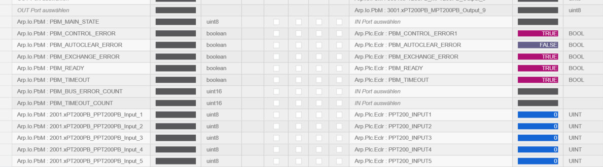

Unfortunately there seems to be no traffic, the online view is this (and doesn’t change):
