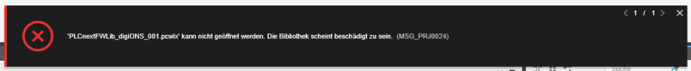

Hello. I was working with an AXC F 2152 with FW2020.6 and Smart Elements and PLCnext Engineer 2020.6.2. I updated to the new soft 2021.0.1 and FW 2021.0.0 LTS in the AXC Then the AXC goes to FAIL (red led lights fix) and the soft gives me the error I send to you. If I come back to the former version of FW2020.6, everything goes well with software 2021.0.0 LTS Do you have news about a similar problem with the firmware update ? Thanks for your help. Best regards. Julian.
