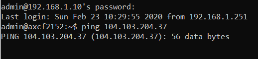

image.pngit show like this ,and I can’t enter the password in “cmd” either
The same IP address and password that works in the WBM page, must also work here.
Note that the password will not be displayed, and the cursor does not move when you type the password.
If you are 100% sure that the IP address and password are correct, then there is something strange going on and we will have to investigate further.

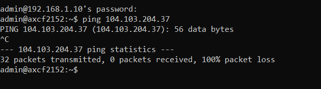

This is a status after hitting Control_C
This shows that you are getting no responses to the ping requests.
If you’re getting no responses from the ping requests, then it looks like the PLC is not connected to the internet.
If the PLC is not connected to the internet, then it won’t be able to connect to any cloud services, including Proficloud.
If you need help connecting the PLC to the internet, please let us know the IP addresses of the devices on your LAN(s), including the internet router, and all the physical connections between the devices (wired and wireless).

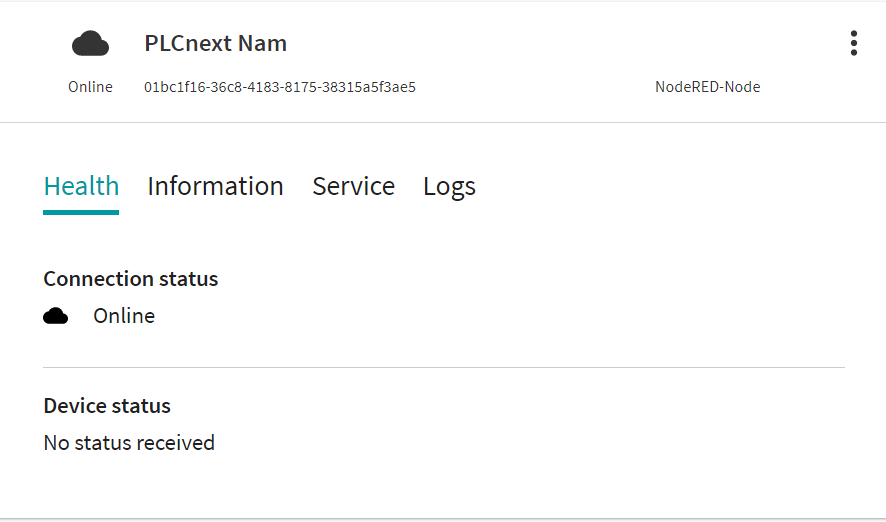

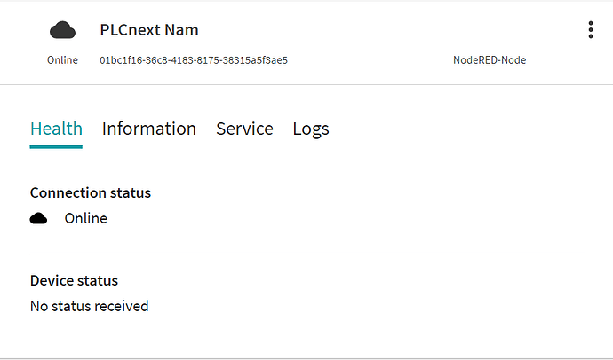

Thanks for your help, i’m do by myself , i’m take Node-red is the intermediate step , but on WBM, it’s still show offline status, and the variable on TSD is not affect , still work
