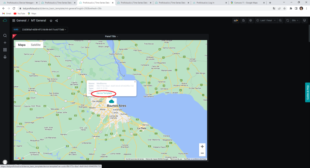

Hi Martin,
I followed your steps and I could add perfectly the link. But I still have the “device Template” link, How can I delete this link?
Thanks, Lucas.
Here is the answer from the Proficloud support team.
> > For further Proficloud support, please use the form on the Proficloud website. <<
_Hi Lucas,__deleting the device template link isn 't possible at the moment. We might add that functionality in the future. Thank you for the input. _
