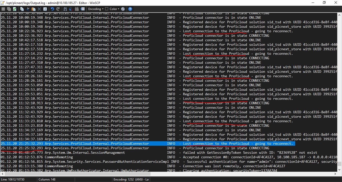

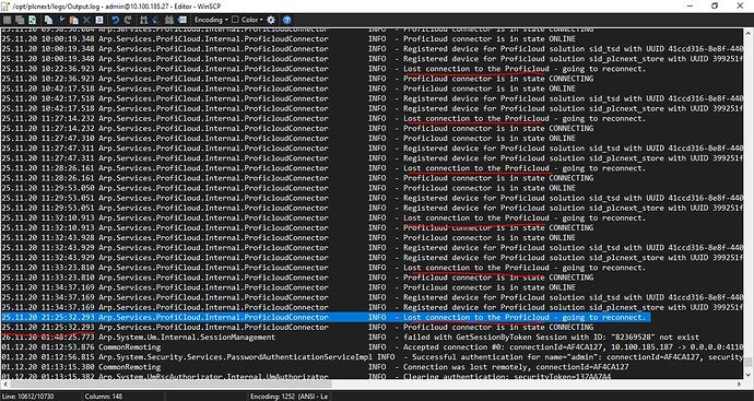

Hi Frank, Thanks for your answer. I met the same problem these days, then I go to check the log file. I found that PLC often disconnects from Proficloud, but it can automatically reconnect most of the time, and the Proficloud can keep servicing. But some time, it cannot be online again, then the Proficloud service will stop. I attached the log file snapshot for your reference. Best regards, Li Zhuoqun
Hello, as there is no Error or warning in the log file, it seems that the connection to the internet is lost. The device tries to reconnect and gets onlie if the profiloud is reacheable. However, with the new firmware 2021.0 you could use the new dashboard at www.proficloud.io , which uses new technologies and which has advanced security measures. For more information regarding the proficloud.io you can also contact inbox@phoenixcontact-sb.io Regards, Arno
