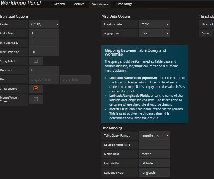

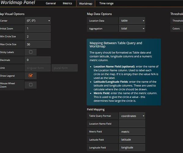

I can´t create the coordinates following the instructions at: https://www.plcnext-community.net/en/makersblog-off/427-latitude-and-longitude-on-world-map-panel.html Can you please help me with this issue.

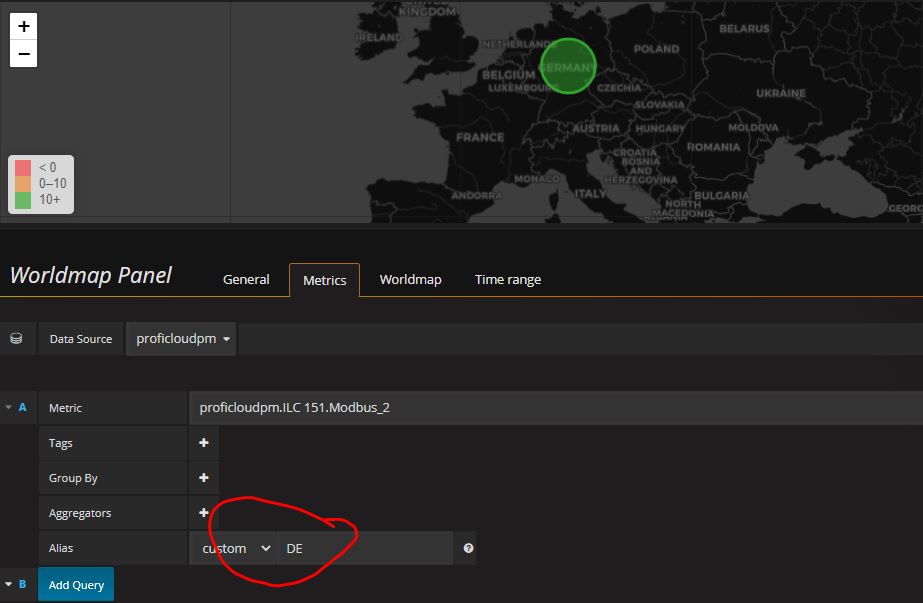

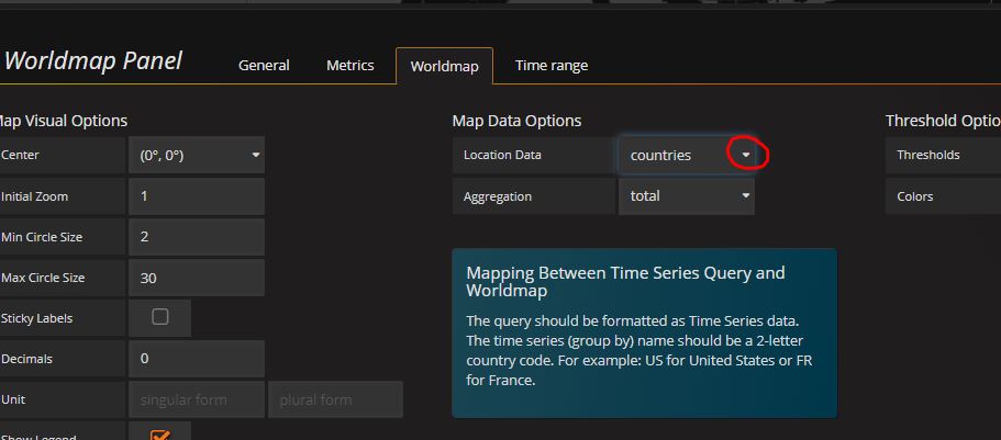

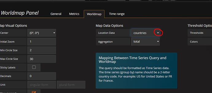

Hi, there are some ways to solve it. 1) Simply add a Country identifier to you metric, like DE for Germany, FR for France in the “Alias” field (see image WP1.jpg) 2) You could also try the table settings and then use the coordinates, see images WP2 and WP3.jgp I hope this helps you. Arno
