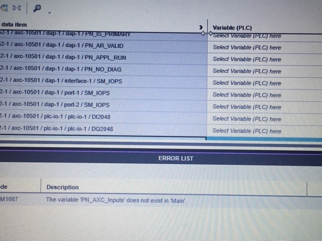

Hi I am Jorge I have an AXC 1050 PLC , working with a Profinet UPS, and I want to get that info from de AXC 1050 since an AXC 2152 with Profinet Communication. I used the information that i found in this forum to establish the Profinet communication between 2 PLC, and i think i have no problem with that ( I attached photo ), because my PLCnext AXC 21152 can read the diagnostics about the condition of my AXC 1050, but can´t read the info about the UPS. I don´t know if I have to make an structure or an array to read with my PLC next, or I can use the RDREC to get that info. So…basically i want to transfer the UPS info since PCworx to PLCnext Engineer Can you give me some guide to reach my goal?

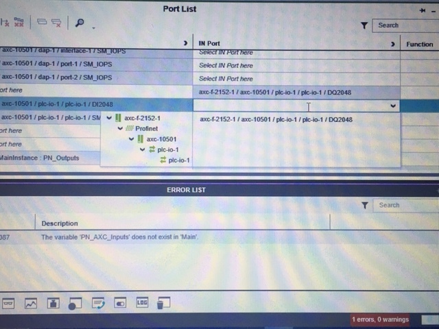

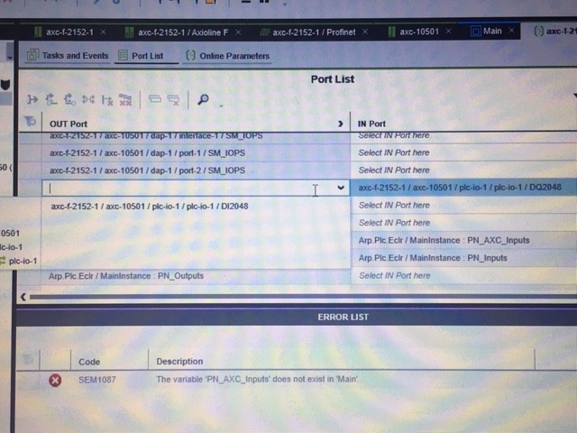

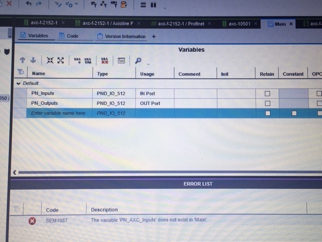

Hi Eduard Thank for your help. I have already read that post before, and I don´t know if maybe I am making any mistake to do the process from video. The name of variables for me is DI2048, DO2048, and the video is with 4096 ending, I think that it´s something just for my version firmware (2020.3 LTS) I have already created the variables in main program (attached photo), but when i tried to make the port link in PLC next section, I can not find the correct way to do it. In the video, Martin makes that , linking the DI4096 with the variable PN_Inputs and DO4096 with PN_Outputs, thats it´s logical of course, but when I tried to do it, only have the acces to link inputs and outputs, and thats not seems correct. Maybe i failes with another step, can you give more information about it?

please create at first the Datatype PNIO_256 (Array of 256 Bytes) and then create the Port-Variables of datatype “PNIO_256” as showed in the Video. It is neccessary, because the AXC1050 controller has 256 In/Output Bytes.
Under Component->Datatype define new Type:
TYPE
PNIO_256: Array[0..255] Of BYTE;
END_TYPE Best Regards Eduard
