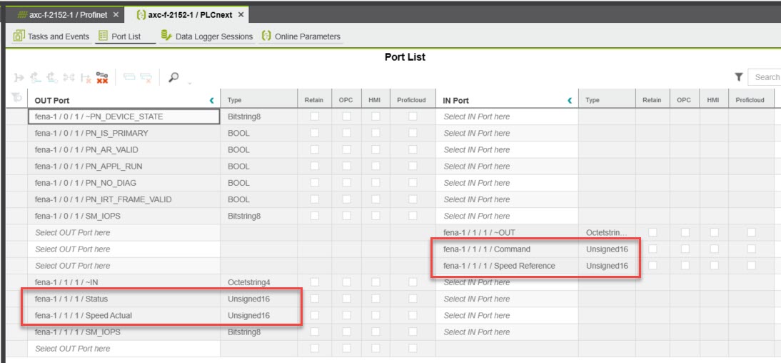

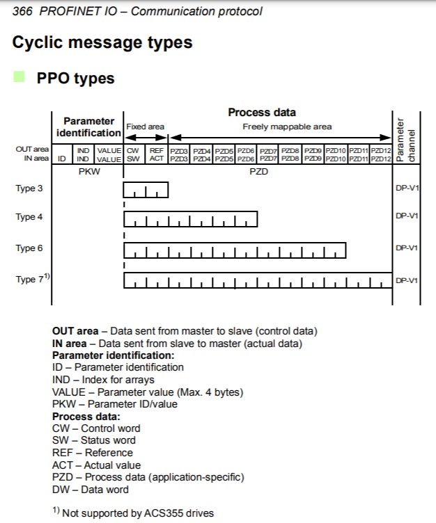

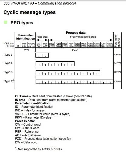

It looks like you need to add at least one PPO type to the Profinet device configuration. This is not specific to PLCnext Engineer, but would be required for any Profinet controller. The PPO types are listed in the documentation from ABB for the FENA-21 interface: [attachment]2021-08-09_13-35-02.jpg[/attachment] After adding PPO Type 3 to the fena-1 node in PLCnext Engineer, I can see these ports in the Port List: [attachment]2021-08-09_13-37-37.jpg[/attachment] (I don’t know if PPO Type 3 is the one you want, please check the ABB documentation). For a variable speed drive, the inputs and outputs outlined in red would seem to be the ones you want. You should link each of these port variables to port variables of the same type in one of your program instances. The data should then automatically be exchanged with the device via these variables. The meaning of the Command, Status and Speed values should be described in the ABB documentation. [quote]do I need to use FB such as RDREC and WRREC or MEMORY_COPY?[/quote]No. If you have trouble establishing a connection between the PLC and the FENA-21 interface, please make sure the “Name of station” specified in the device “Settings” window in PLCnext Engineer matches the Profinet name that you have given to the FENA-21 Profinet device in the field. I hope this helps. .

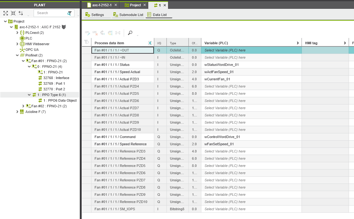

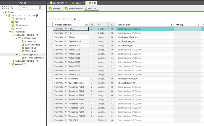

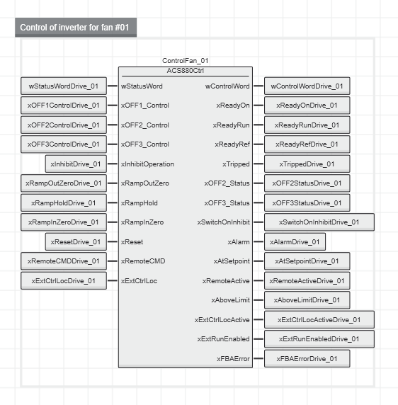

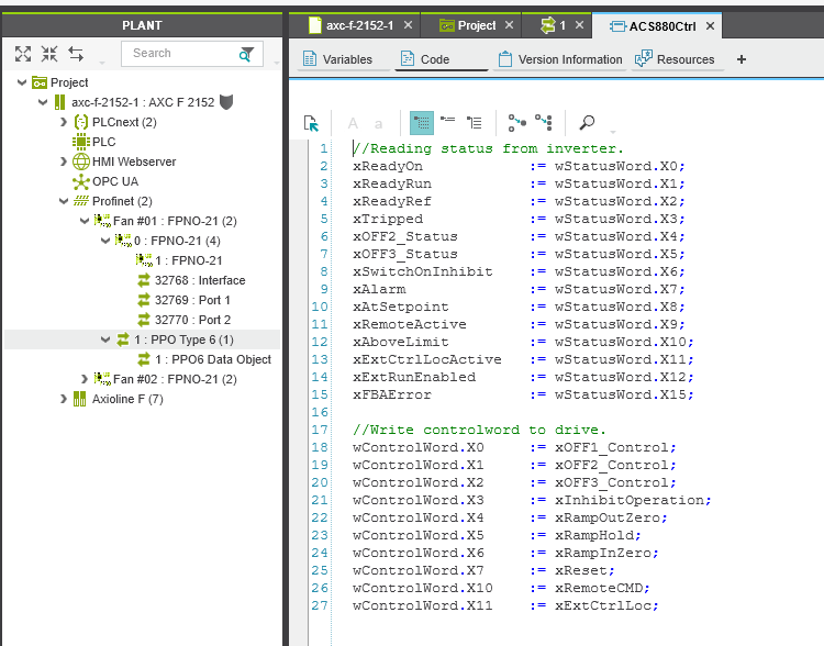

You don’t need to generate anything in PLCNext Engineer. But you need to add the PPO type as sub- object. The PPO type defines the number of values you receive from the ACS. The PPO types are descripted in the manual for the FPNO-21. There you also will find the definition for the single bit’s in the control and status word. I have attached some screen dumps from one of my projects. It is with some ACS880 but the FPNO-21 is working the same why in your application. Be sure to note what bit’s in the control word have to be TRUE by default. Again, you can find that in the manual for the ACS and FPNO-21 In the PN_hardware you can see the basic hardware setup. FB_internal is my take on the control function. The FB_program is how it looks in the program. If you run in to problems, drop me a line and I will assist you in more detail. Peter Paul
