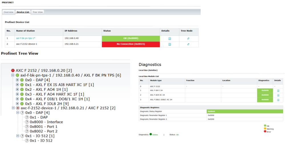

thank you for your response and support. The Profinet diagnostic feature in the WBM of the PLC was extremely helpful in identifying connection errors. I managed to resolve the BF-D issue on the BK, and it now appears correctly in the tree.
However, I’ve encountered another issue: there’s a red indication on the PLC. I suspect this might be related to the Profinet controller configuration in the PLCnext. The BK seems to recognize the Profinet controller, as it is visible in the web diagnostic (Connected Profinet controller 1). Additionally, the IP address of the Profinet controller is within the same subnet as i have changed the subnet again for the other devices (see screenshot)
Could you help me understand if I might have misconfigured something or clarify why the Profinet controller isn’t functioning as expected?
Thank you in advance for your assistance.
Hi SHNB,
great, that the WBM gave you already some useful information.
Based on the screenshots it seems that you’ve also another AXC F 2152 as Profinet Device in your network.
At the beginning you’ve stated that you are trying to connect the 2152 as controller with a TPS BK as device.
So, this might be kind of missunderstanding.
If you really have another 2152 in you network and you like to use it as Profinet device, it must have the configured Profinet name and must be in the same network, so that the AXC F 2152 (as controller) can find and configure the device.
But if you only have the BK connected to the 2152 (as controller), you don’t have to add the 2152 as device into the network. So, it maybe not even necessary…

Initially, I assumed that adding another AXC F 2152 as a device (to be profinet controller) in the configuration would not be necessary, since i dont really have it. However, without adding it, the BK’s web diagnostic consistently shows “0 connected Profinet controllers.” This leads me to believe there might be a misconfiguration in my PLCnext configuration. And if i add in the profinet section the actual controller it says that the name and ip address is already used in the project.
