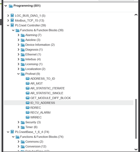

Have you tried the IP_TO_ADDRESS function block inside the PLC Next Controller library?

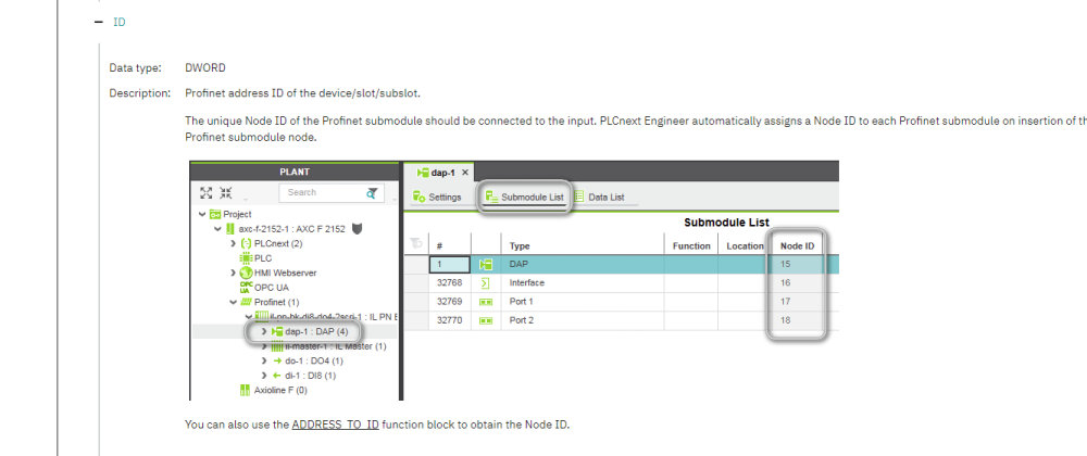

The FB seems to need as input an “ID”:
Data type:DWORD Description:Unique Profinet address ID to be converted to the Profinet address structure ADDR.
Do you know how can I get this?

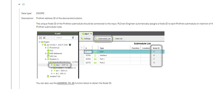

In the help file for a different profinet function block (RDREC) I found this:

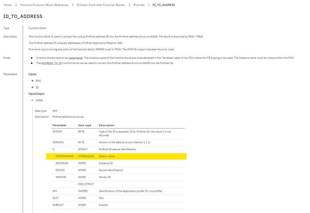

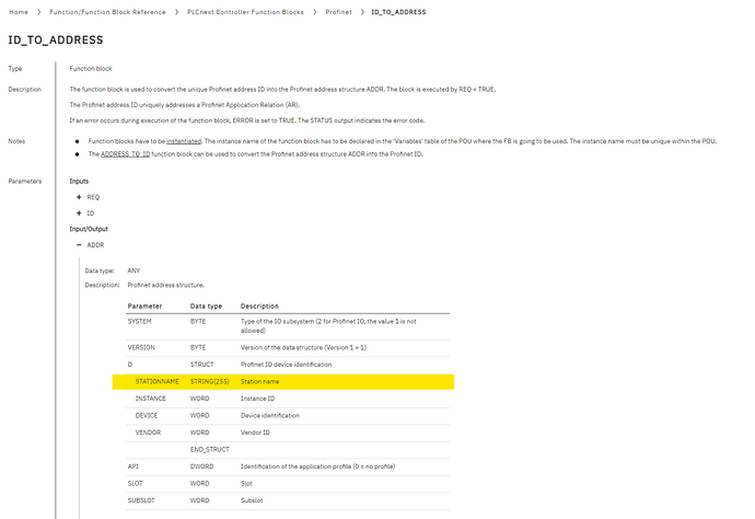

Thanks again for your reply
What I’m looking for is showing on eHMI the station name of the PLC acting as profinet device.
This FB seems to get the profinet station name of the devices when the PLC act as profinet controller.
