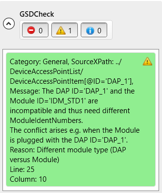

I have checked the GSDML file with the GSDML checker. There are no errors but one warning (see picture). As far as I can see, the used schema of the file is version 2.2 which is very old. Maybe there is a newer version available. The latest schema version is 2.35.
