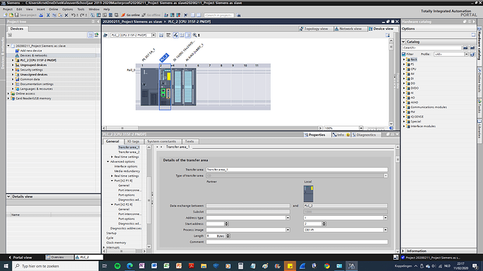

My best guess is that it has something to do with the way I call the records where the data comes from. In the attachments you can find how the datablocks in the siemens PLC’s are defined and how I use the WRREC and RDREC funtions. Thanks in advance, Arne

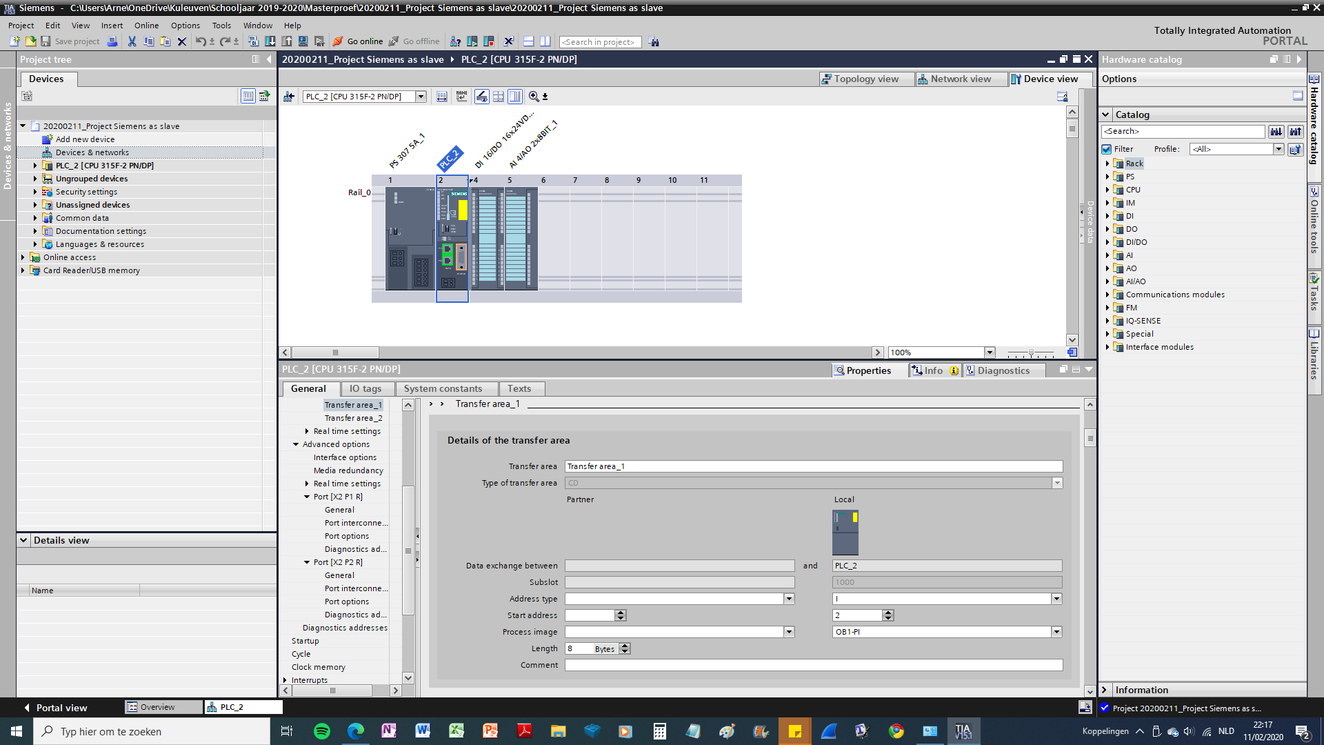

Hi Martin, Thx for responding so quickly. As you asked the Siemens s7 is configured as a I-device and the AXC is the controller. The project is about new communication methods with a PLC s7. I’m going to try to work with node-red, c++ on/off GSD and one another language. I thougth that WRREC and RDREC where the only options to get the data out of the PLCvia Profinet.
So I wanna try to get it to work the way you are explaining. I already found how to setup the I-device and the transfer area but I’m not sure how to implement it in PLCnext.
The problem is that with the gsdml-file I found online the PLCnext controller is not recognized as controller but as a device. I’m not sure the PLCnext controller can work without that connection (see image) and how to acces this transfer area in the PLCnext controller.

I already found how to setup the I-device and the transfer area …
This is almost all you need to do in the S7 PLC. As a Profinet device, the S7 PLC does not need to know anything about the AXC - so you do not need to import any GSDML file(s) into TIA Portal. GSDML files are only used by the Profinet Controller - so, the AXC in this case. But which GSDML file should you import into PLCnext Engineer? This needs to be the one that describes the S7 PLC (Profinet device). I am not 100% sure, but I understand that in this case you must generate a GSDML file in TIA Portal, using the procedure described in section 4.8.2.4 in this document: https://support.industry.siemens.com/cs/document/19292127/simatic-profinet-system-description Once the GSDML file is created in TIA Portal, you should export it, and then import it into PLCnext Engineer. You should then be able to create the Profinet Device in PLCnext Engineer, and connect up the IN and OUT ports on that device. These ports will contain the data from the S7 DBs that you defined in TIA portal. After finalising the configuration, when the AXC (Profinet controller) starts up, it will automatically start transferring process data to and from the S7 PLC, without the S7 PLC needing to do anything else.
