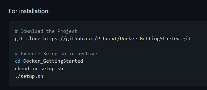

The recommendation in this case would be to use Balena Engine using the procedure described here:
https://github.com/PLCnext/Docker_GettingStarted
If you can give us details of the step in the installation procedure that is failing, we can try to help.
Contacted Phoenix Contact and was recommended to Podman which was preinstalled. I don’t know who recommended this, but Podman is currently only supported for use with PLCnext Store applications, so Podman is not the recommended solution in this case.
Thank you Martin, I have explained that the installation of Belena would not install in point nine. Nothing from the Docker_GettingStarted Github page would install. There where missing folders or files being called when the bash script is being ran.
Hmm, that should work, so hopefully we can find the problem.
There are two main steps for Balena Engine installation:
image.pngWhich of these steps (Download the Project, or Execute Setup) gave errors?
Can you post a copy of the error messages?
