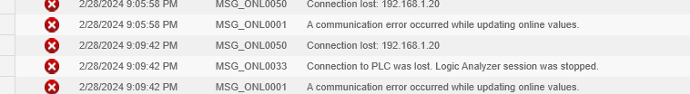

Hello, Sorry that I’m asking this question on your forum, I’m not 100% sure if this is because of Eclipse or it’s the makefile or something. I’m not capable of debugging, and the error it gives me I tried to google it but the answers did not work for me or I did something wrong during that. The error I’m getting is in the attachment. Also I added the debug configuration.
