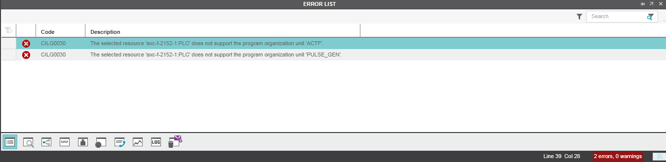

Hello Sir, I had a strange problem in the test PLC:AXC F 2152 :2020.3 PLCnext Engineer:2020.3 PLCnextBase:PLCnextBase_1_3_0 I use the putty command to override the running project, but I report an error and restart. root@axcf2152:~# cp -r /opt/projects2/* /opt/plcnext/projects/
2020 Aug 10 10:39:10 axcf2152 Arp.System.Acf.Internal.Sm.ProcessesController FATAL - Process ‘PLCnextBase’ has exited unexpectedly.
2020 Aug 10 10:39:10 axcf2152 Arp.System.Acf.Internal.Sm.ProcessesController FATAL - All other living processes terminated immediately.
2020 Aug 10 10:39:10 axcf2152 shutting down the system because of error 3 = ‘No such process’ (Ps.Please see the attachment for specific questions. I don’t know why the pictures can’t be uploaded.) After restart, the RUN and FAIL LEDs flash. I think it should be that some system services of plcnextbase have not been stopped, but how to handle them is not clear. Please give suggestions. Thanks a lot! ************************************************* Best Regards, Zhang Wu IMA Marketing & Technical Support IMA Segment zhangwu@phoenixcontact.com.cn
