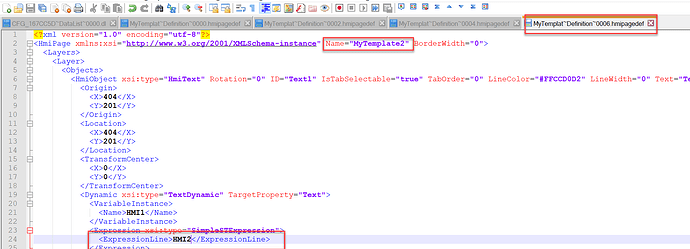

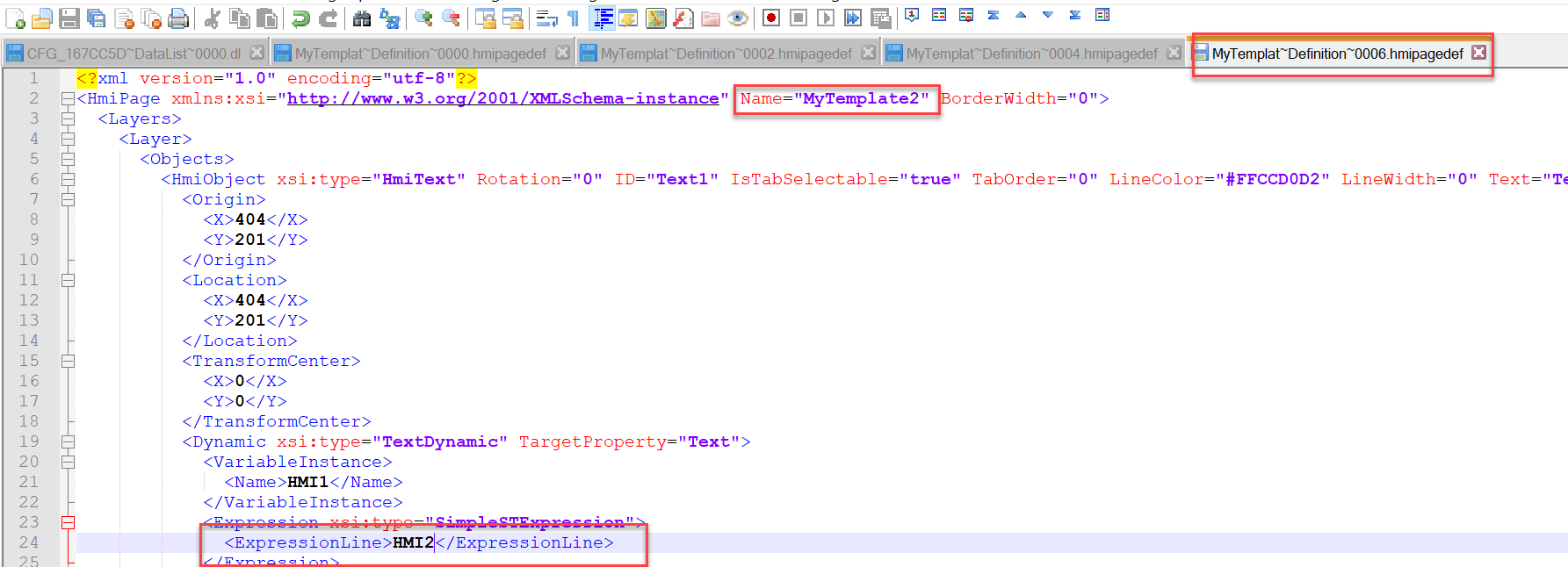

Hi Arne, you can make use of the flat file format option, were you can carefully modify single files. [list] []Save the project as pcwef (uncompressed) []Open the .hmipagedef files of your screens created from the template (just an xml) []Close PLCnext Engineer []Search for the VariableInstance and modify or change the value → make sure that the variable exists [*]ReopenPLCnext Engineer [/list] Please find attached a small example were I’ve created a new screen from a template and were I changed the default HMI Tag “HMI1” to “HMI2”. Take care, Frank
