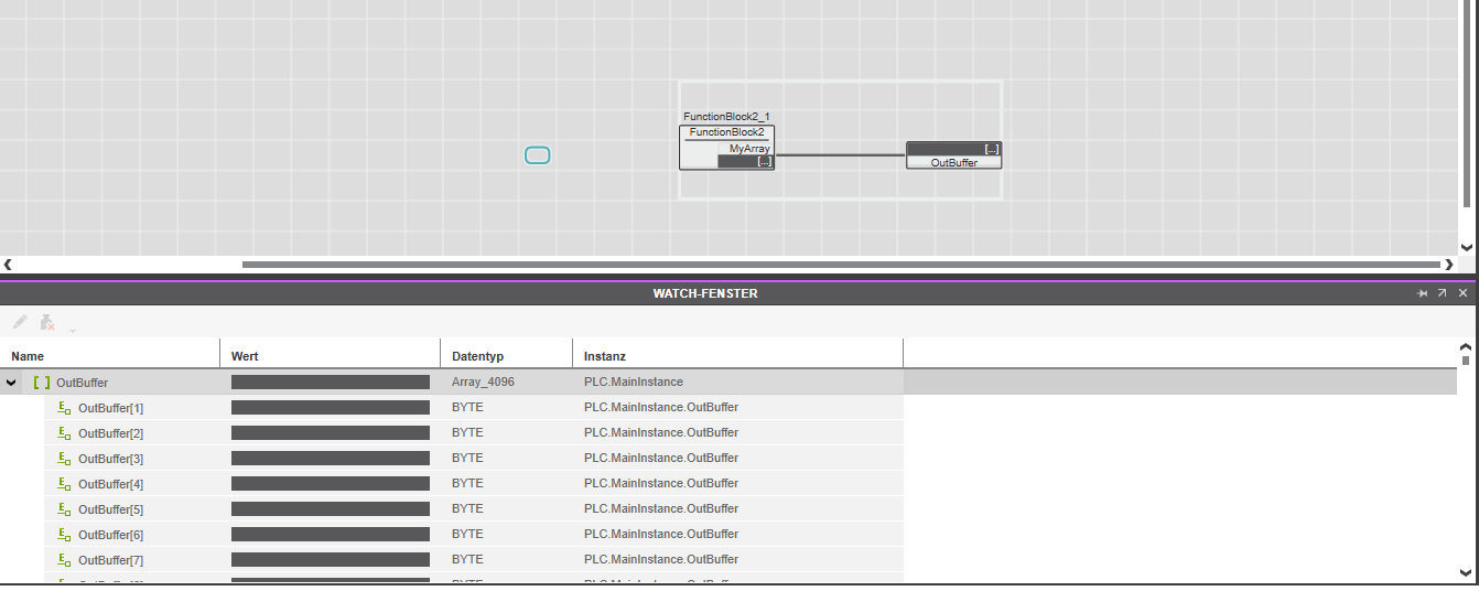

I’m attempting to use the Radial Gauge Scale but I cannot connect the dial to a tag value. When I watched a video on how to create basic visualization I noticed that the PLCNext Engineer in the video appeared to have a parameters tab for the dial. I have an analog signal that I would like to place on the HMI. I have attached a screenshot of my version of PLCNext Engineer. I am using the latest version of the software.
