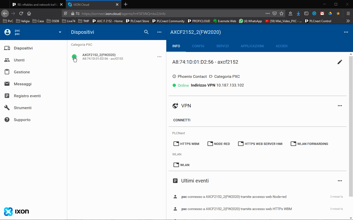

Dear Jan, Unfortunately I understood late your suggestions, and I 've to done many tests. now it works, I confirm It’s realy important the priority “-100” in the prerouting otherwise it doesn’t work. I used this nft rools table below: #!/usr/sbin/nft -f
define ixon_v4 = 172.16.5.0/24 table ip ixon { # chain ixon_forward {
default forward policy is drop
#type filter hook forward priority 100; policy accept;
oif eth0 accept
# accept any established connection traffic
ct state established,related accept
#} chain prerouting {
type nat hook prerouting priority -100; policy accept;
tcp dport 1999 dnat to 172.16.5.1:443 #mguard
tcp dport 2000 dnat to 172.16.5.2:80 #Wlan 5100
tcp dport 2001 dnat to 172.16.5.7:80 #FL Switch 2208
} chain postrouting {
type nat hook postrouting priority 100; policy accept;
oif eth0 masquerade #this is valid for local connections not for ixon
} Now the AXCF2152 wth IXON client can reach other devices than itself ! We GOT IT ! I attached a gif showing right behaviuor. Best Greetings Fabrizio
