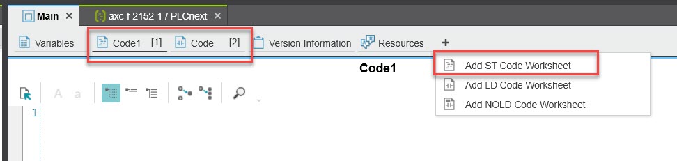

Dear Martin, Thank you for your response. Yes it seems that I can add different cyclic with the probability of having one instance for each. Although it would works for me if I could wrap up everything in a single worksheet, question is that if it’s worth to separate everything in individual ST worksheets? I mean speed wise. Best regards, Mehran.
[quote]question is that if it’s worth to separate everything in individual ST worksheets? I mean speed wise. [/quote]If you mean “worksheet” in the way that it is used in PLCnext Engineer (see picture), then no - within one POU, it makes no difference how many worksheets your code is in. Worksheets are simply for the user’s convenience, and in the PLC the code in all worksheets is executed as if it was all in one worksheet. [attachment]2021-09-28_15-32-25.jpg[/attachment]
