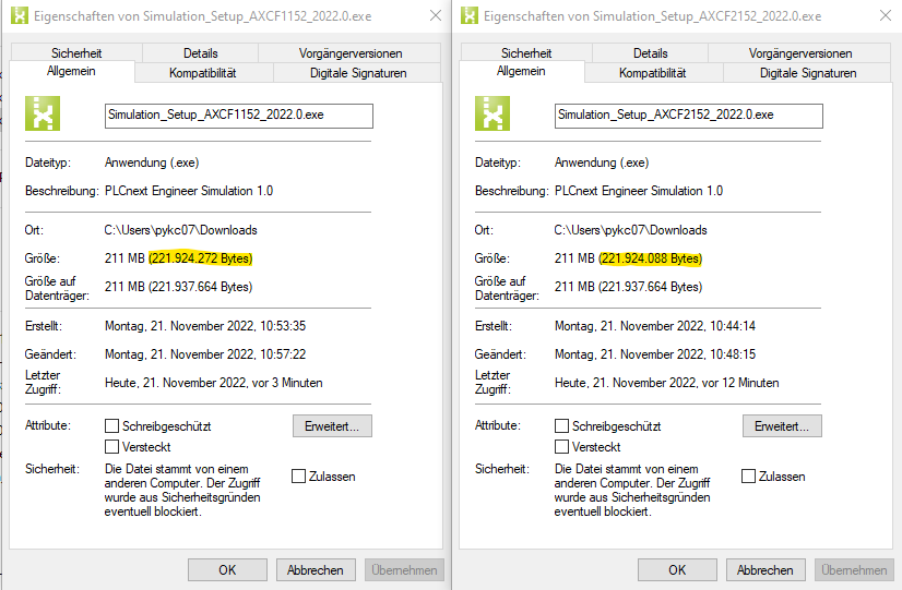

Thanks, but can you check the download file in your Website. I download 2 file AXCF1152 and AXCF2152 simulation but when I install only one AXCF1152 run and F2152 is not find the license. An anomaly is two file is same size although it is different version. You can notice that.
Thanks for support.
Hi bomoirau,
The simulation files are OK, I checked them. The reason why the files sizes are the same is easy - the firmware of the 1152 is a derivat from the FW of the 2152. So typically they match for 99%.
the 1% leftover can be found if you see the details of the files :wink:
