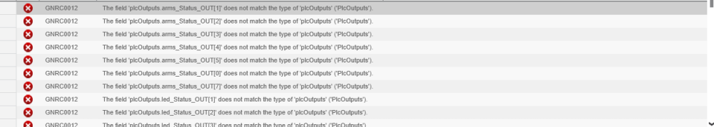

I have a problem in PLCnext Engineer for quite a long time now. I am using PLCnext Engineer 2024.6
The problem is that when I rebuilt my project in visual studio, then sometimes in PLCnext Engineer I get errors like this.
What I then have to do is disconnect all of these variables and reconnect them exactly the same way so that the error disappears. This happens in GDS Port List.
Since I have way too many variables and this is very time consuming is there a way I can work around this bug?
Thank you for your time in advance.

Regarding the first problem I described: it seems to be happening when I add another variable in an already existing struct which I have already connected part of its variables in PLCnext Engineer.
