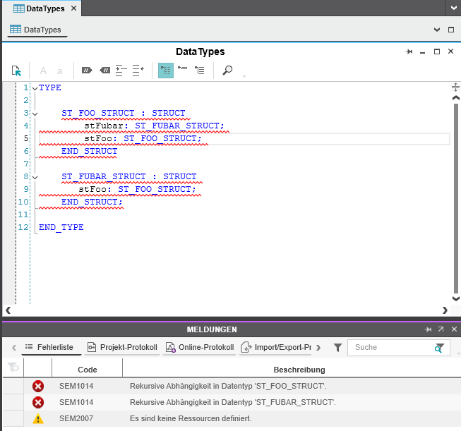

PS: On a completely different note: if you reference an element of a structure to the structure itself, the PLCnext Engineer crashes.
Are you able to give an example of a minimum Program POU that demonstrates this problem? Screen shots will be fine.
Unfortunately, I can no longer reproduce this problem in a blank project (error - no crash):
In other words, I managed to crash the programme once with this constellation. But we’re probably talking about a one-off glitch here, and it might only happen in 1 in 100 cases.
Ok, so PLCnext Engineer sometimes crashes when it checks the type definitions and sees the circular/recursive references, but it usually behaves correctly and reports this as a compilation error in the Message window.
