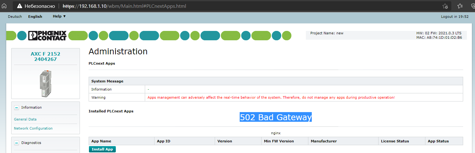

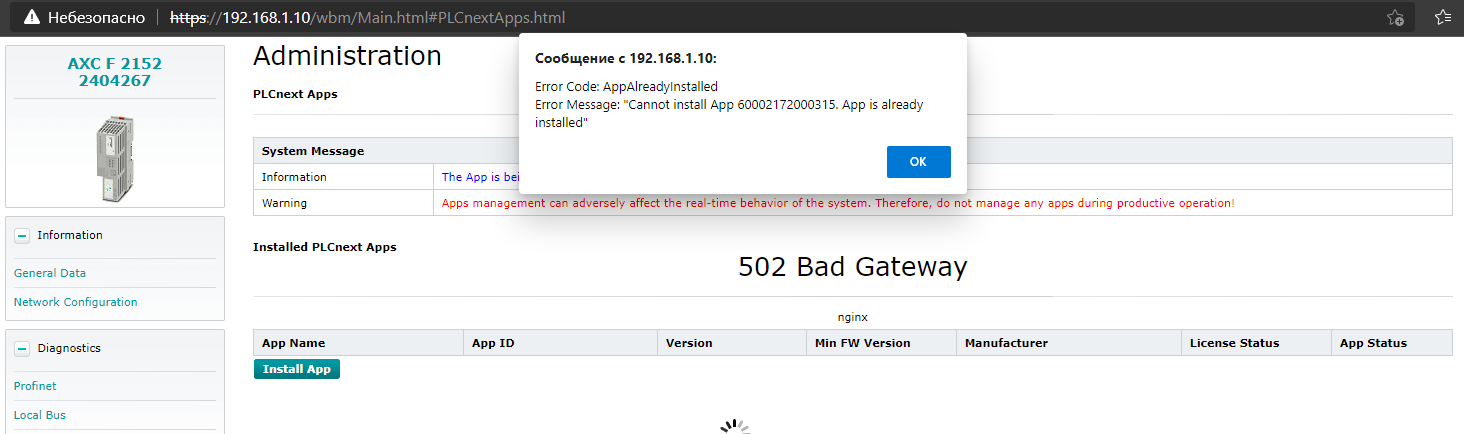

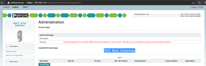

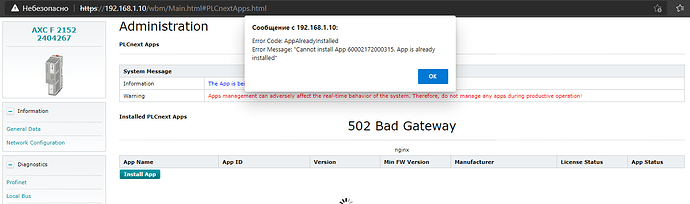

How to install PLCnext Patch PndOff offline?
