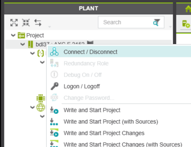

Instead:
* Establish the VPN tunnel
* Open your project for the remote PLCnext.
* Right click on the remote PLCnext in the project tree and select Connect.
Hope this helps (if not you, then someone else looking for an answer).
