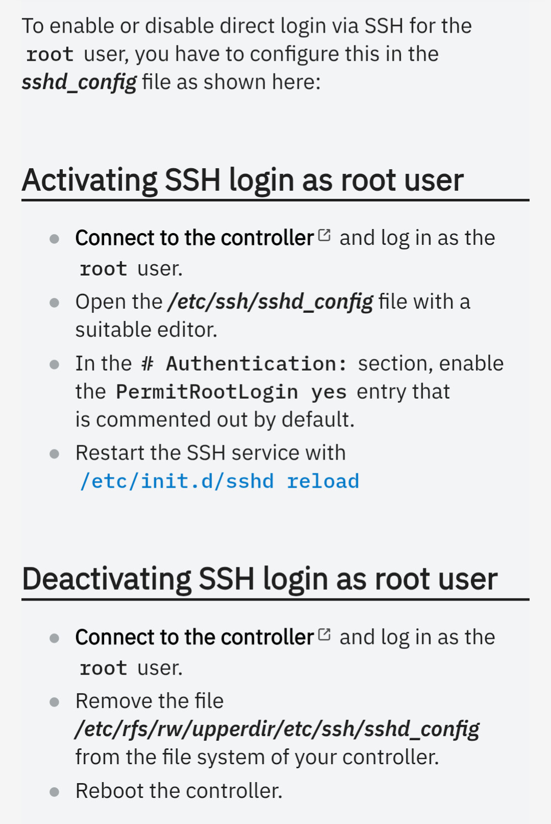

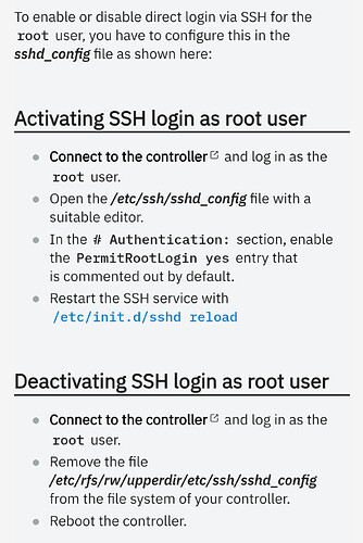

The blog post you linked to says that the root user must be able to log in using ssh. That’s not just a matter of setting the password for the root user. In the Info Center page that you linked to, there are instructions explaining how to enable ssh login for the root user:
Hopefully this will allow you to proceed through the instructions in the blog post which, at the end, should allow you to debug a C++ program running on a PLCnext Control device in Visual Studio.
