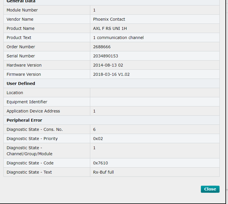

Hi, Please see the following error. the LED state of the RS UNI module is D: Green, UI: green, E2 Red. Also, the document does not give a clear picture of where to connect the terminating resistor. If possible, could you describe where to attach(which terminal point) the terminating resistor? Should we use the internal resistor or put an external resistor?

The “Buffer Full” just means that you are not processing the recieved Data. So the recieve buffer will overflow…
Make sure that all processdata connections are setup correctly.
