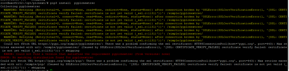

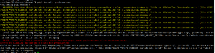

I am facing problem regarding the command
image.pngfor this command it give error even though it is connected with the internet.
I am using the axcf2152 firmware 2022.3
thanks in advance
Hello.
Please check that the date/time on your PLCnext Control device is set to the current date and time.
This can affect the validity of SSL certificates.
thanks for the prompt response
okay
it work
